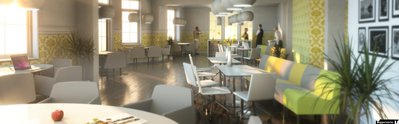

This sneak preview is a crop of a larger interior render.
The original for the client is very sharp everywhere.
I did some quick blur post production on this sneak... oops, I did it again
...I wanted to hide some details that I did not like to be sharp.
It is DL rendering, because that gave me the fastest result when trying some settings in PT,PMc and DL.
the original is 3200x2400px and took about 10min to render.
I mixed the AO rendering a little bit (25-15%) on top of the Dl render to make it more lively; it had nice effect on the whole image and a great efect on the ceiling..(which you cannot see in this crop
Another thing I did was mixing a render with bloom effect and one without... this way I have more control on the visual inste4ad of finetuning when saving final render... just save it twice (with and without bloom effect)
I hope you like the overall atmosphere. C&C are always welcome ofcourse.
