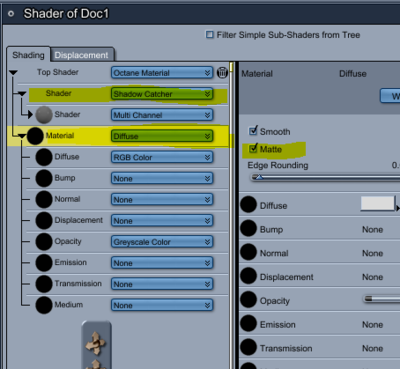

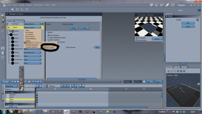

shader/Lighting models/Shadow catcher

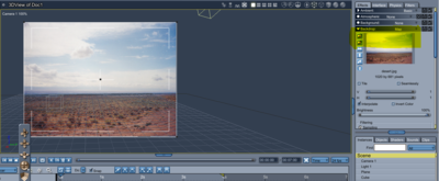

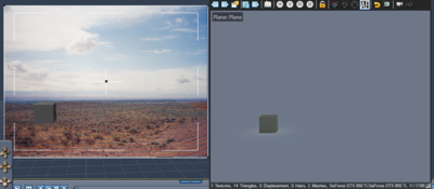

Enable Alpha Channel in Render Target settings..
Use DIFFUSE and make sure MATTE is selected ;)

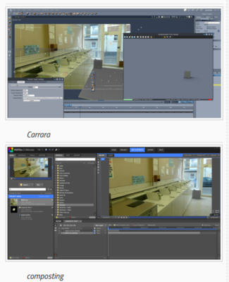

Backdrop (not currently supported in OR4C), you will need to do some comp work..
BD2
BD2
COMP both render & background in another program/video editor..
You should then be able to composite your render & background in another program or video editor ;)
