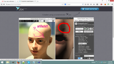

here is the link YOUR screenshot in increasing
http://joxi.ru/3PIjVP3JTJAHTEQNthA
there are visible artifacts

Hi - I can see the artifact in the Poser mesh too. I suspect there is an issue with the mesh at that point cause is causing rendering problems.
Daylight rendering is effectively a very small point light - so any mesh issues are going to be problems. "texture environment" lighting on the other hand is far more forgiving of these mesh issues because the light is coming from all directions.
Paul

face_off wrote:Hi - I can see the artifact in the Poser mesh too. I suspect there is an issue with the mesh at that point cause is causing rendering problems.
Paul

However, in other applications, this problem is absent.
none of the developers had warned me that there is a problem!
when I was paying for the program
If you set the sun size to 10, the problem also goes away. So there are many workarounds. And if you give Otoy a chance - they will look into the problem.
