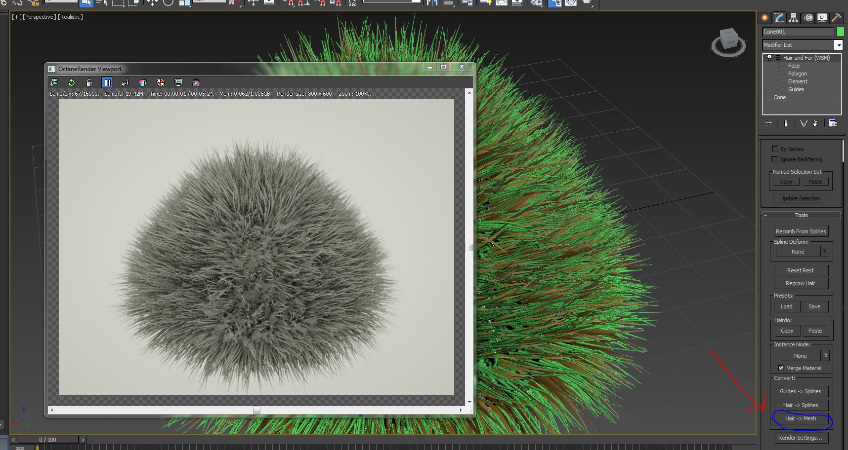

I don´t know what I´m doing wrong, but octane render viewport doesn´t render hair&fur.
Is there special settings? Or something what I´m missing?

going to hair and fur effects panel (pressing 8) and then choosing hair rendering options as Geometry helped me

I ran into the same issue, but converting the fur into a mesh worked. It eats up more resources but does the trick.
See Attached Image
