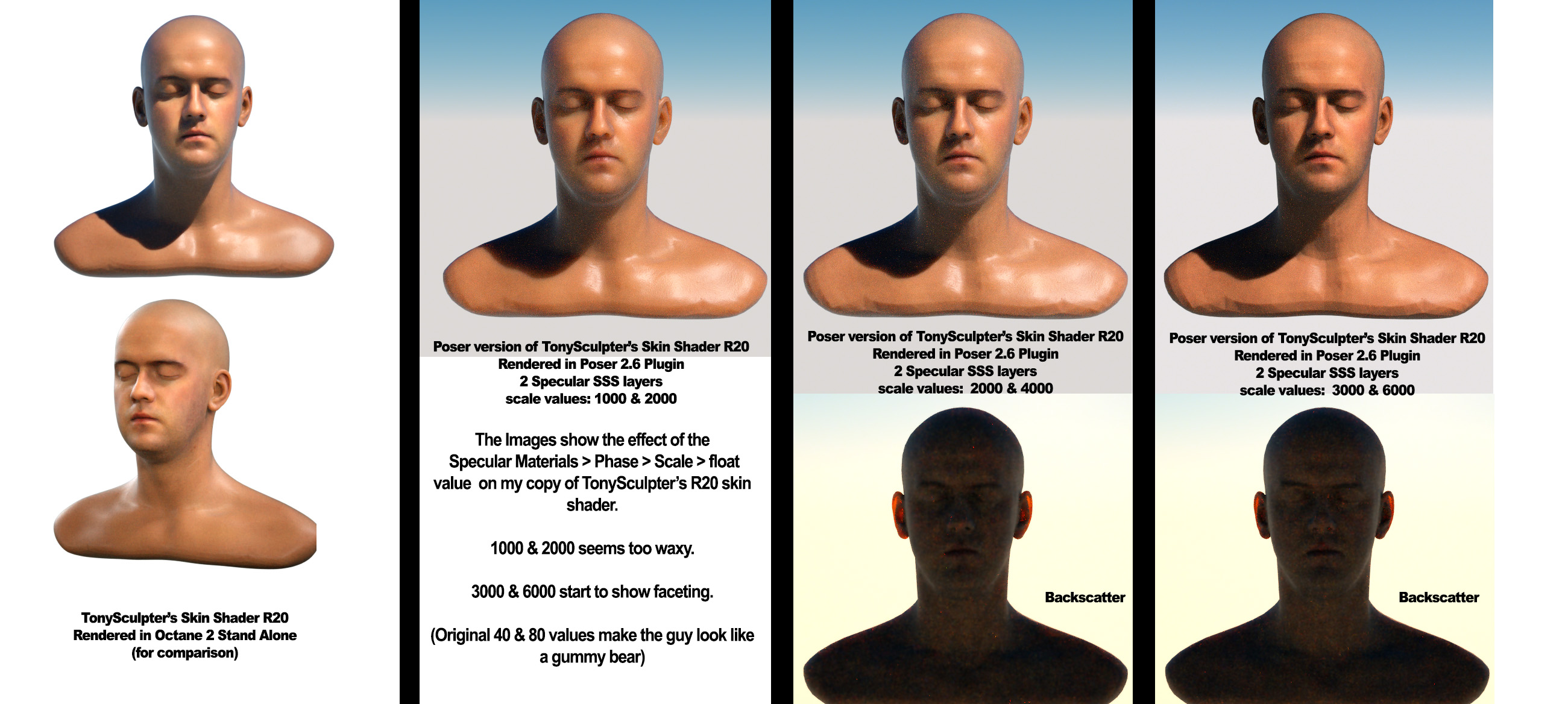

Paul, I've included the image to illustrate the issue. (I got the high scale values by hand-editing the .poe file.)
Low values, with this shader, caused a gummy bear effect!

The actual amount of scattering is the "Scatter" and "Absorption" multiplied by the inverse of the scale. So setting the scale from 100 to 1000 is the same as reducing the Scatter from .8 to .08 (I think). Transmission is also a factor, so reducing the transmission has the same effect as increasing the scale.Paul, I've included the image to illustrate the issue. (I got the high scale values by hand-editing the .poe file.)
Also : the comparison renders you have put together....the head in Standalone - is that the same size as a Poser head? Would be worth making sure all the scales of the geometry are roughly the same.

The thing is, TonySculpter's shader uses a RGB color in the scattering and an RGB image in the transmission, so I don't know if there's any way to reduce the values as you outlined.
Good point. I'll have to check - if I can figure out how to measure items in the Standalone. What's interesting is that values of 1,500 to 2,000 (in the first specular) and 3,000 to 3,500 (in the second) get me great looking skin - the best I've ever gotten out of Octane (or Vray for that matter).Also : the comparison renders you have put together....the head in Standalone - is that the same size as a Poser head? Would be worth making sure all the scales of the geometry are roughly the same.
It's in the color correction node - the brightness and brightness scale (I believe.)I will need to fix this. Which slider specifically goes to 20 pls?
Export the scene from Poser to OBX, then load into Standalone, and then manually set the camera position/target and fov/scale to that of your Standalone test scene. The heads should render the same size if they are scaled the same.if I can figure out how to measure items in the Standalone.
