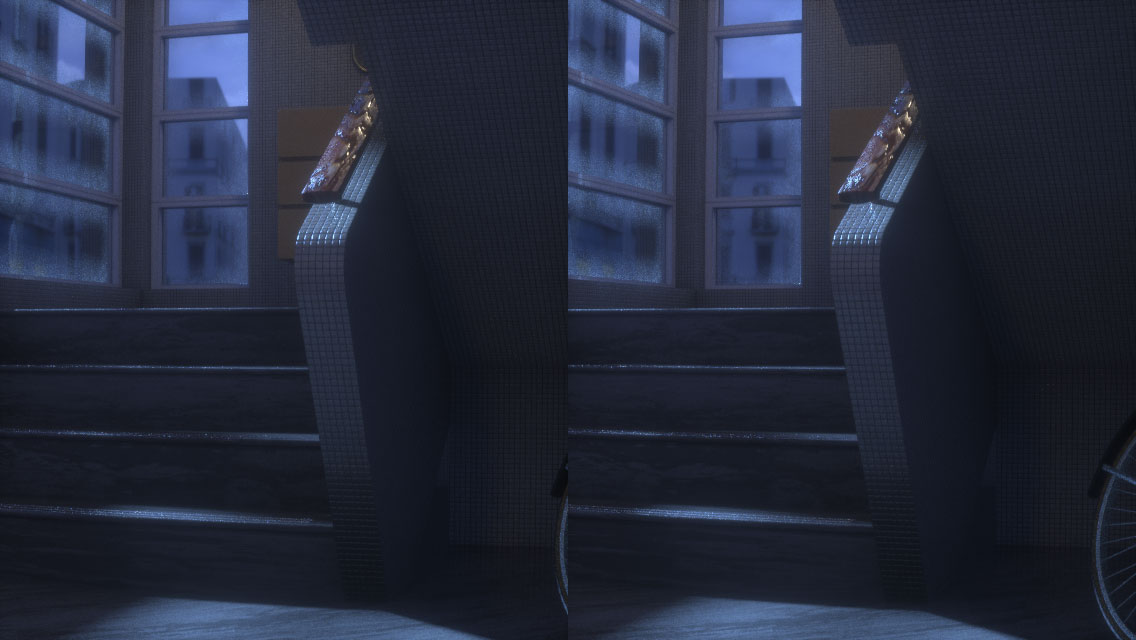

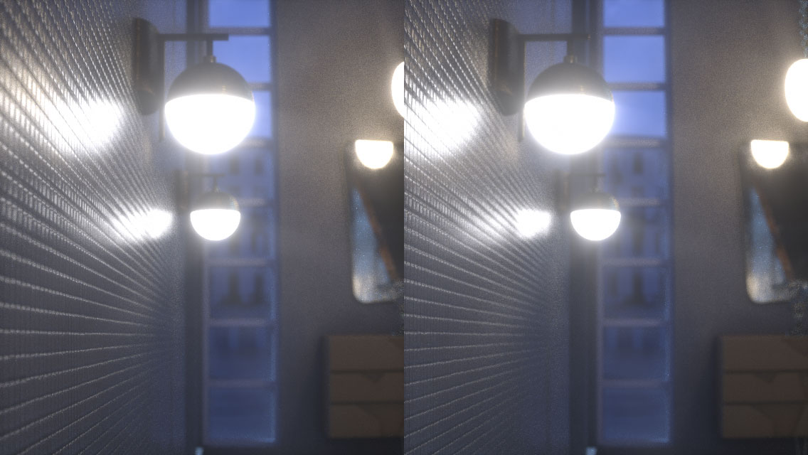

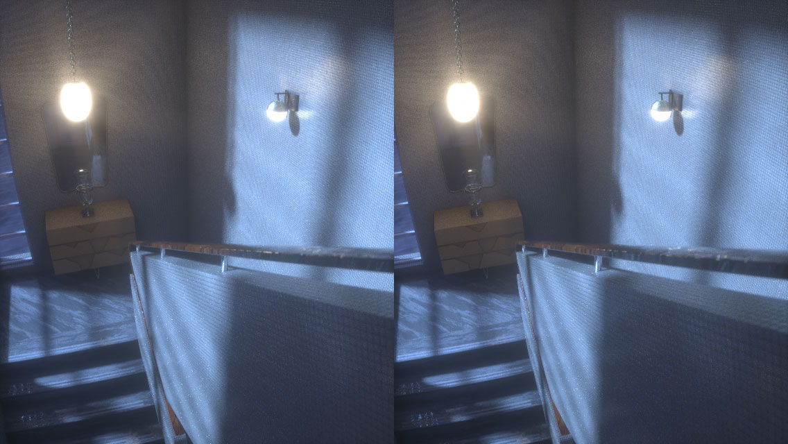

Below are some pictures and a sample animation created with OctaneRender ™ V2.0 to test the viewer
