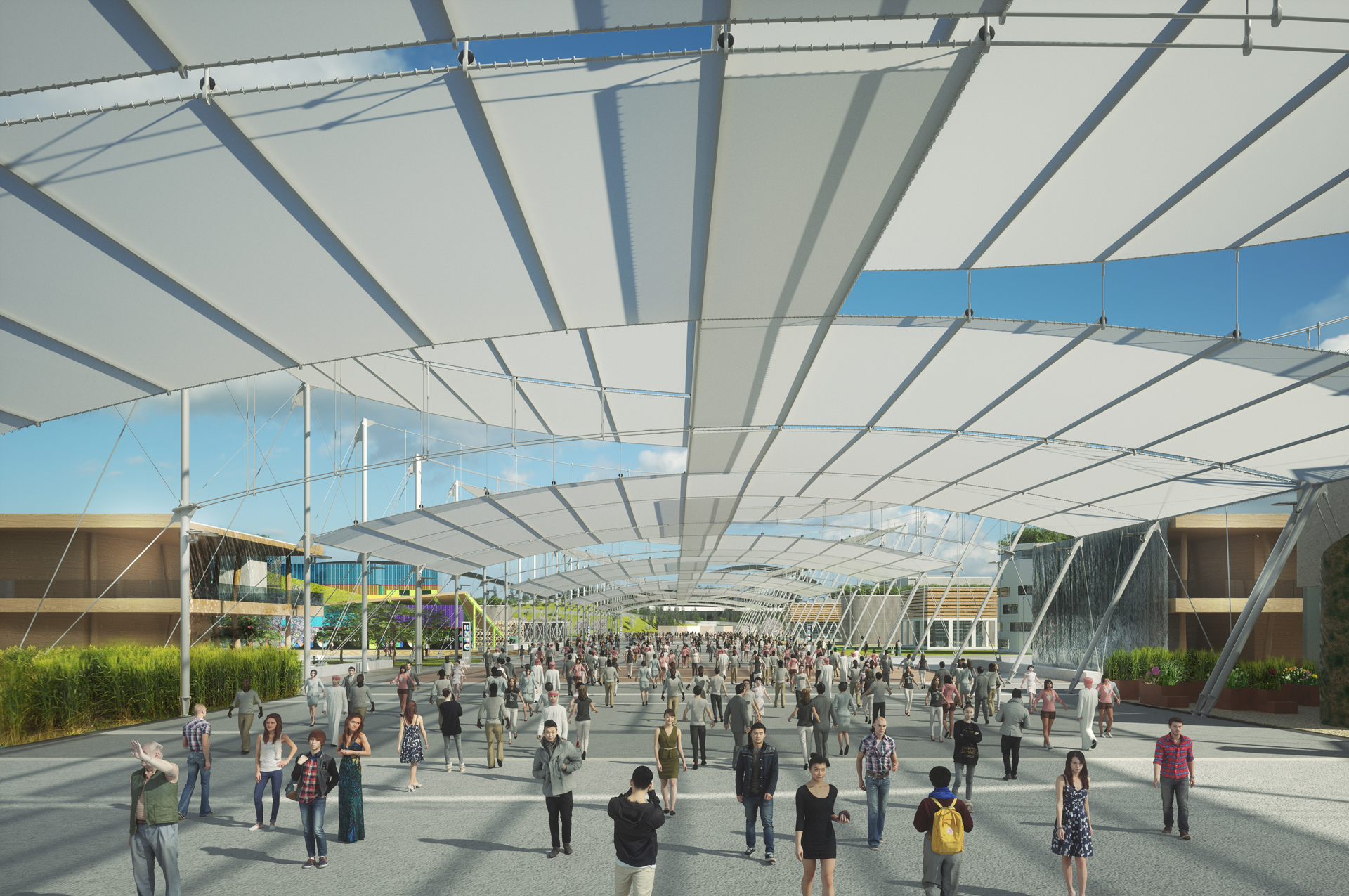

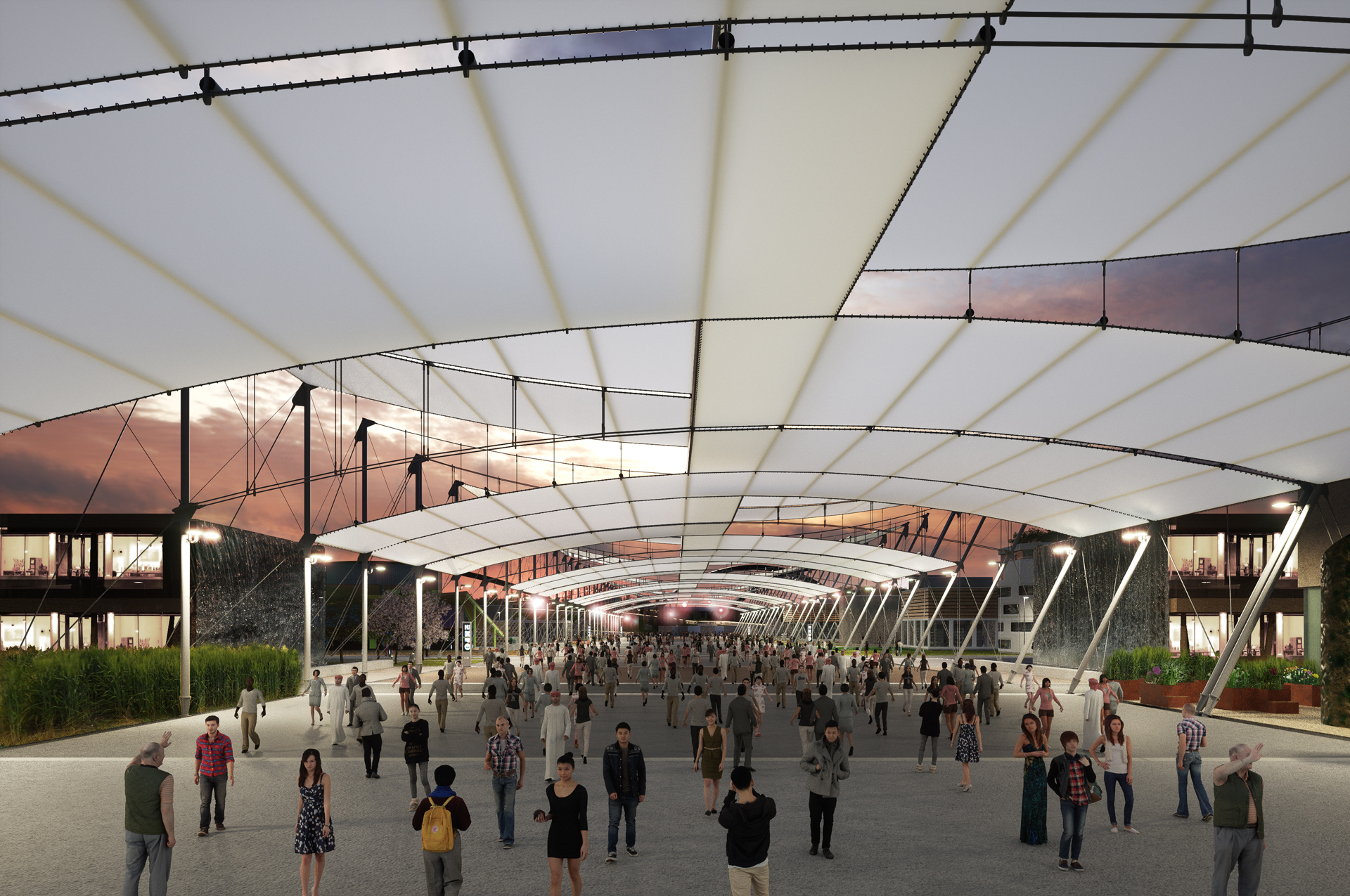

here is an example of a material i've made some time ago for Attu Studio and the EXPO 2015 presentation in different light conditions:
unfortunately i've not the scene here with me, but i can tell you that the tent has thickness with a Cloth Nurbs and the material is a simple specular with sss medium node. Just play with absorption (very low value), scattering color and scale to get the proper result ;)
