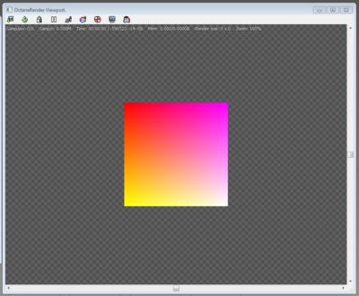

I just wanted to use max 2015 (I was on 2014), so I install 3dsmax 2015 on a slave machine.
When I saw that max and max design are not compatible, I uninstall max and install max design.....
When I install octane render 2.06a plugin, the installer don't see maxdesign 2015, just maxdesign 2014, and if I choose in the installer dropdown max 2015, it can' find the path, just "C:/", I manually browse to the 2015 root and install.
All elements are correctly installed (each element is at his place)
But when I make a little scene, and open Octanerender viewport, nothing render (see screen capture)
If you can help.... What can I try to do ?

What log says?

Hi Karba, thanks for reply.
As I don't know where I can find the log, I search and see that no GPU was active after install...
Now it works...
The big problem is that in 30 days I will not be able to open the 3dsmax design slave anymore, so it would be nice to be able to configure the GPU without opening max !!!!
