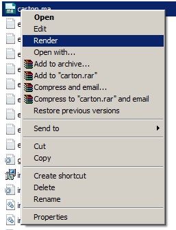

If you need to batch render the scene using network rendering - close Maya and run the batch render from the context menu of the scene file in explorer window.

for Mauriko,
it's too easy my friend, just set up the render settings and close maya.
then right click on the scene file then click on render, that it :)

I don't have a Render context menu for my Maya 2015 or 2106. What is the workaround?
