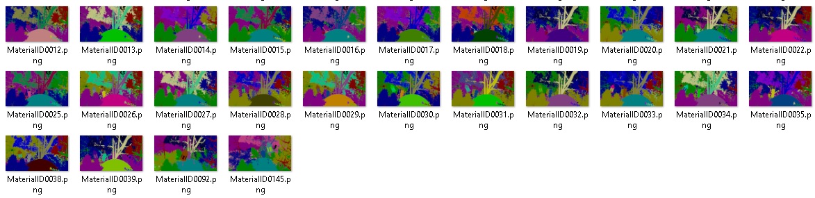

We are into the final phase of rendering our short film.
Iam using the info channel to render out Material ID:Pass. But it seems that the ID color just changes every frame. The blender Plugin does not seems to be sending out consistent material ID pin to the octane server.
Iam a little stumped.
Iam using OctaneRender for Blender 1.55
Material ID Pass
Material ID Pass

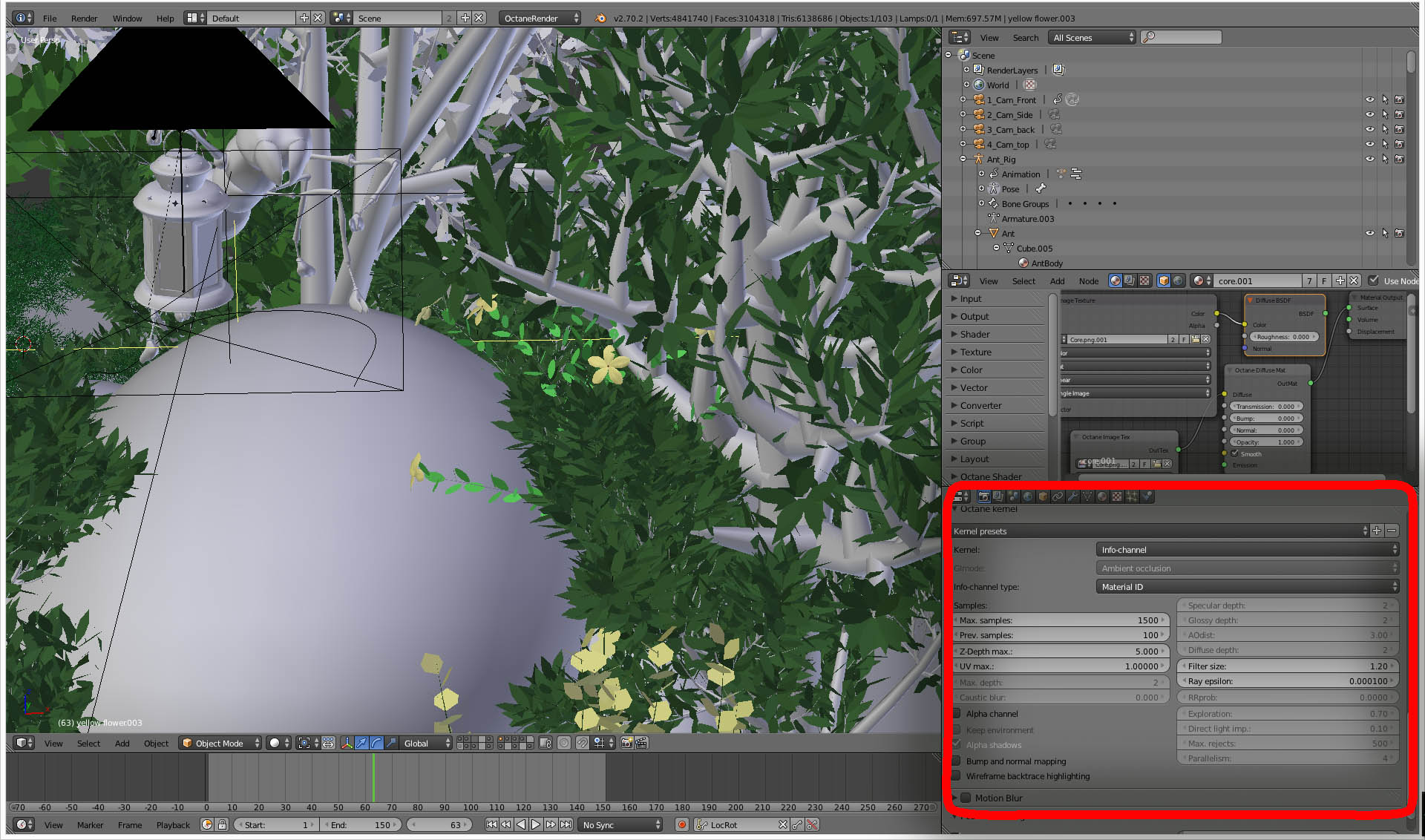

Snapshot of Blender

JimStar
Posts: 3836
Thank you for report, I've reproduced it. Will fix this.
