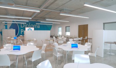

im working on an interior scene for a client and im getting weird Arc type Artifacts on the back wall, also on the pod in the center.
Anyone come across this before?
							Weird Artifacts?

Increase a litle step Ray epsilon ...and concentric artifacts gone.
						- gabrielefx
- Posts: 1701
 - Joined: Wed Sep 28, 2011 2:00 pm
wrong units-scale...
