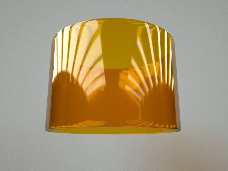

I'm working with the SSS materials trying to create a glossy plastic cap but it really doesn't work anything like expected. I'm working with a specular material and you can see below the difference in colors. This image is even after I've adjusted other settings to a point that aren't technically correct, but they help at least get to a point that I could tweak in photoshop.
Can anybody give me some guidance on this? Am I just doing this wrong from the beginning or is SSS still buggy since it's new?

Hi itsallgoode9
First try lowering the reflection on the specular material if you have not done so. Alternative option to try is using a mix material with diffuse for SSS and glossy material for reflection. You should be able to get better result. For diffuse material set color to black and use transmission color instead. Then add your scattering medium to this as well. For glossy material try index to 1 for full reflection.

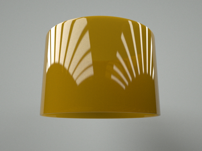

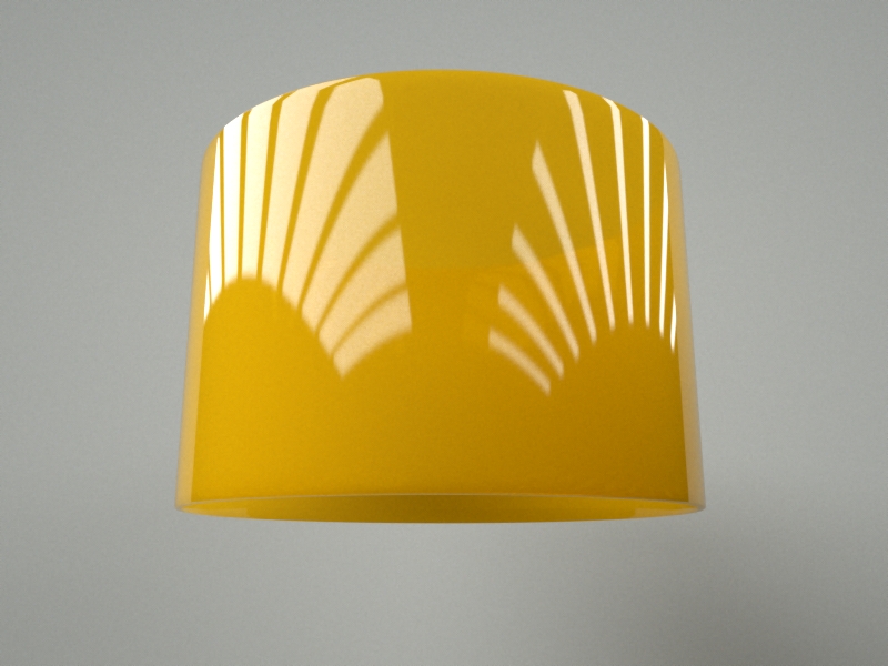

Didn't save that scene, but here's a similar one.
Another idea, though - how high is your diffuse depth?
[Edit: Images were supposed to be in reverse order, sorry for any confusion]
Depth 16
Depth 16
Depth 4
Depth 4
No SSS
