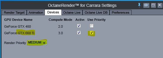

Little hint, which im sure you are aware of. If you have 2 video cards do not attach a monitor to the second card if you want the most memory for rendering. If your main card allows you can attach 2 monitors to that card. you will be able to set the priority on the second card to Medium or higher.

Tugpsx wrote:Little hint, which im sure you are aware of. If you have 2 video cards do not attach a monitor to the second card if you want the most memory for rendering. If your main card allows you can attach 2 monitors to that card. you will be able to set the priority on the second card to Medium or higher.
The attachment RenderPriority.JPG is no longer available
Thanks Tug ;)
So, being new to my 3card setup..
How do I know which card my monitor is connected to if all the cards are the same model?
I just assumed the 1st card in the list would be my display card (PCIE 16) the middle one would be my PCIE 8) and so on.. Am I wrong?
How would you have optimal settings for my cards? Cheers for bringing this up as it has been playing on my mind!
My understanding of a PM from Sighman a while back, I want the display card unchecked and on low priority or the other two cards checked only on either med or high! Have I misunderstood Sighmans PM?
GPU priority settings

Yes that appears correct, where is your second monitor connected. both monitors should be connected to the main display.
Try this in the plugin. Deactivate all the cards and then change the view in you scene it should not update
select the 1st one which should be your main notice the amount of free ram
move around and you may find it a bit sluggish, well actually not cause you have 3GB ram
Try each card separately then the 2 unmonitored cards together
then you can add the 3rd if you like.
