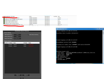

my version are standalone 2.06 maya 2.04
version does not match.
Please see attached photos.
Please resolve

You need to run the 2.04 slave, from the 2.04 standalone: http://render.otoy.com/forum/viewtopic.php?f=24&t=41308
