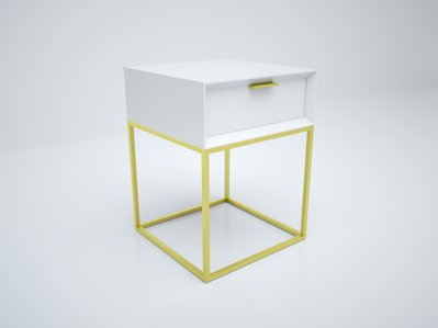

how do I add anti aliasing to the gap between the drawer
dive
Posts: 78
Joined: Thu Jul 10, 2014 5:35 pm
If you the notice the line is slightly choppy in this render:
is there a way to sharpen it?

hi,
do you have a geometry overlap in that zone?
anyway you can play with the 'filter size' in the kernel setting to get rid of the jagged edge ;)
ciao beppe

great Ill def check that feature, thanks!

if not, check your ray epsilon, scale it up and down and see if it goes away
