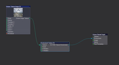

I do not know how to hdr light studio HDRLS_environment of setting in octane. comes out only after the description of the setting toturial I can explain how to apply the octane the environment ever? Can be applied to the octane setting where the environment?

How do I apply / add an effect / backdrop environment / HDRLS_environment HDR_light_studio? I do not like the image I want to apply the setting method.

To use HDRLS with Octane you don't need to add any environment plugin. You only need to enable HDRLS in a Octane scene (enable HDRLS after enable Octane) and you should see in the IPR in real time the HDRLS environment. Also you can use the LightPaint feature clicking over the IPR window with CTRL+Left/Right buttons.
