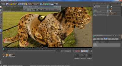

Posts: 16066
Location: Türkiye
this is a quick test with 650000 hair strands
dive
Posts: 78
Joined: Thu Jul 10, 2014 5:35 pm
gorgeous, woah
