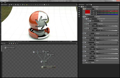

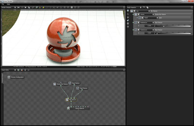

believe me it always works, althou is a little tricky to get a hold of it with a texture, so here is what I do I use a mix map, in the mix channel I add the texture I want to control reflection or roughness with, in the other two channels I add 2 floattexture nodes, that way I can fine tune the amount of glossiness I get with real time feed back.
Here is an example with a plain red glossy material and a checker texture to control glossiness.
Hope it helps
Cheers

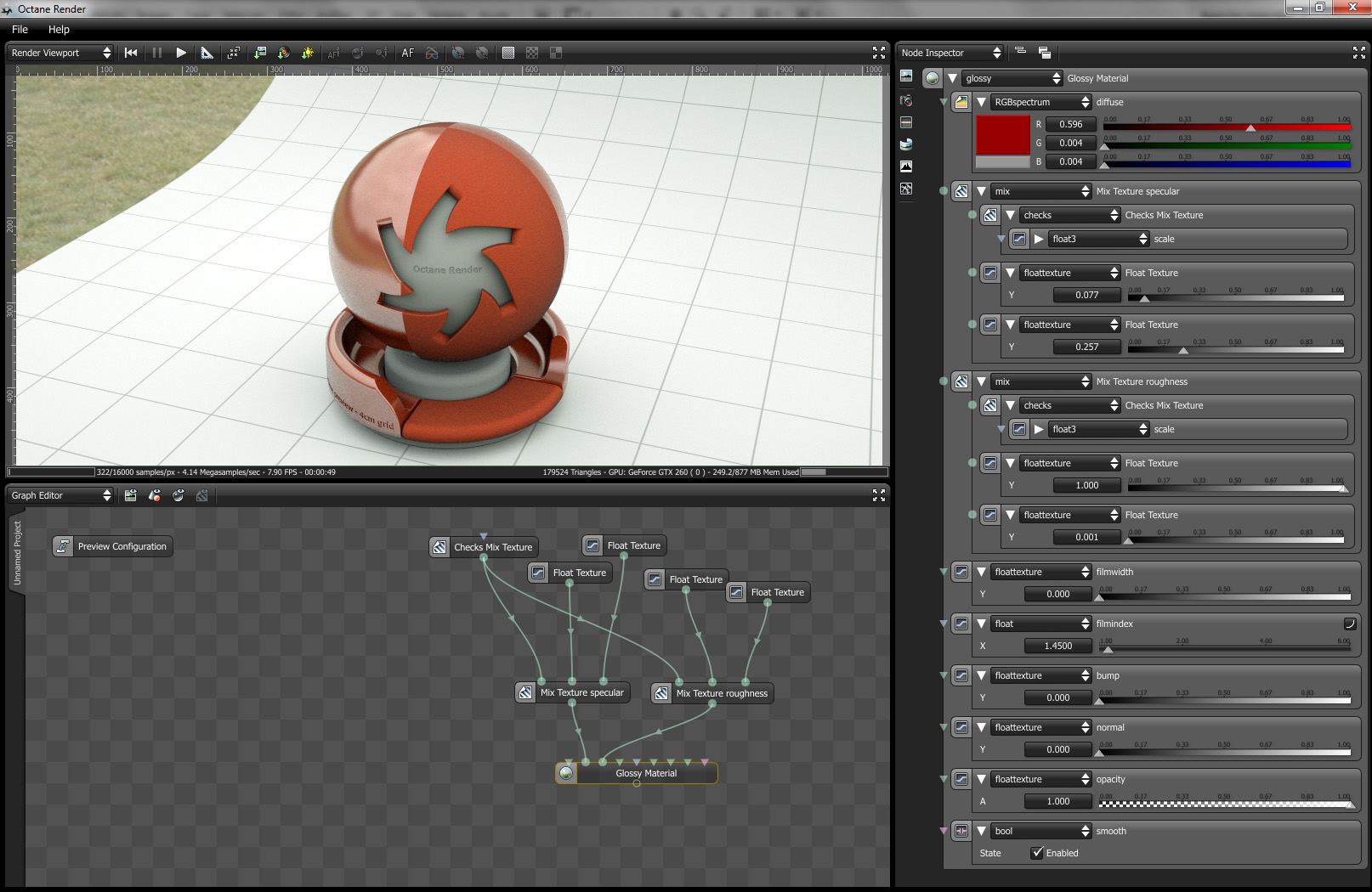

Well, since it seems my first example wasn't clear enough here is a second one, again the material is a glossy one with a red color applied to it. A check map controls the reflection areas, if you check the right column you can see the setup, with high values (1) of roughness plus low specular (0,05) the material is almost diffuse (right side of the ball), on the other hand medium specular plus low roughness (0,01) gives a shiny metalic look.
Try playing around with a similar setup and you'll get the hang of it.

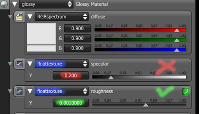

Нow to make floattexture like this, with the curve and with such large values problem in floattexture , because the one that I add does not have such large values
