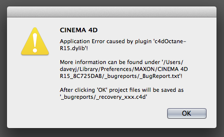

Hoping you can help me troubleshoot this crash. Screenshot and Bug Report Uploaded. If I remove Octane from my Plug-ins Folder, all is fine. Are there any known conflicts with other plug ins causing this?

have you updated your nvidia driver to 335 or newer one? 2.0 needs latests one. Also you can test your system in standalone to see it's working or not.

Thanks for your response.
Standalone is functioning without crashing.
"have you updated your nvidia driver to 335 or newer one"
I have the latest CUDA DRIVER for MAC 6.0.54
Where would I find the latest NVIDIA Driver 335 or newer?
Much thanks for your help

Just a follow up to say thank you for your quick responses. Removing all other third party plug ins did not work. If you can look into what my issue on this is further, i'd greatly appreciate it.
NOTE: I have the latest octane standalone and the latest octane c4d plugs that you have posted.

You noted matching standalones
i have 2.0.6 of standalone and 2.0.5 of c4d plug
is there a matching set?

it's not a problem on matching the versions. Maybe a problem there if you saved octane windows to startup layouts.

I will try to reinstall octane without startup windows. i did have them in there. I'll report back. Thanks again.
