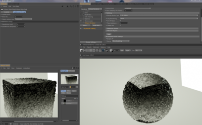

Hi Aoktar,
For me subdivision level doesn't work in the final render too, it only works in the live viewer.
is that normal ?

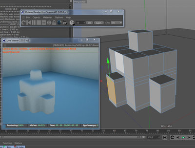

If you are trying to subdivide displacement - you will not be able to do that.
Subdivision works with plain geometry, including primitives. To see it renders in the picture viewer as well you need to -
1. In Render Settings - select Octane as your render engine of choice.
2. Set "Resend Only Updated Objects" (preferably in combination with "faster rendering") from the method drop-down in the Octane Renderer Settings.
This should do it.
