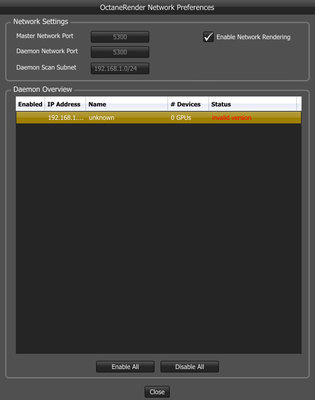

I'm trying to use the network rendering through a multiplatform setup.
Master is a PC, slave is a Mac. Is it supported ?
I detect the slave but I have a status "unavailable" or "invalid version".

Here is a screenshot.

Wrong standalone version!
All info is on this post
http://render.otoy.com/forum/viewtopic.php?f=30&t=40570

I've already double checked and they are both running on 2.04

When I use the last version in the download page (Standalone 2.04 and c4d plugin 2.03) it's not working.
If I use the last version 2.04.1 on the link you posted it's working.
