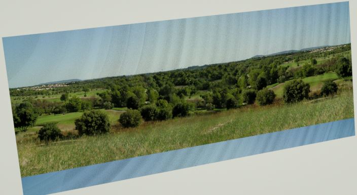

no the first time i have this problem…
A simple diffuse picture on a poly (planar mode)…
I usually copy/paste my scene in a new document and everything is ok, but this time… no way…
Known problem ?
Thanks for your help.
(Cinema4D + R15 + octane plugin)

Looks like a Ray Epsilon issue.
Try taking this setting down a bit.

Yes ! in fact i had to increase it a bit : 0,005 instead of the default value (0) - (i've never really touched this settings before… :roll: )
Seems to work now. Thanks a lot ;)
