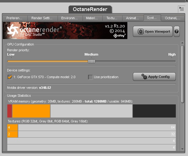

I, too, wanted to know if the models were too large. So I loaded three trees (I tried to load one, but they come as a set apparently, and I haven't yet broken them apart). Although I only have 1 GB VRAM, for these three models, I have excess. Attached is a screenshot of available VRAM and the current render per the view finder.
