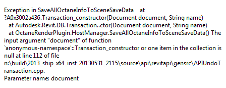

I received several unrecoverable errors while opening project #1, after which I did a save-as, and project #1 worked. Then I began working on Project 2 for about 2 hours and tried to save and received the following error (see attachment) - both projects were prob open simultaneously for a time if it matters.

That crash is coming from inside Revit when the plugin is opening a transaction in order to save the Octane nodes to the Revit scene. I have not seen this error before. Normally if Revit cannot open a transaction if will display a warning as such.
Is Revit crashing - or is it just displaying this exception message and then continuing to run?

The image relates to crash #2 in project #2 (ill get to crash #1 in project #1 shortly)
I had opened project #2 before closing project #1b (the save-as), I suspect this may have contributed to the issue. after which I closed project #1b and continued work on #2 for 2 hours. It was when saving to close #2 I received the error in the image.

OK - that version is from quite some time back - and a lot has changed in the plugin with version 1.5 and 2.0. My suggestion is to just work on one Revit scene at a time - and you will not see that error. If you ever get a crash, a "journal" file will be written, which will generally state the reason for the crash at the end of the file.
