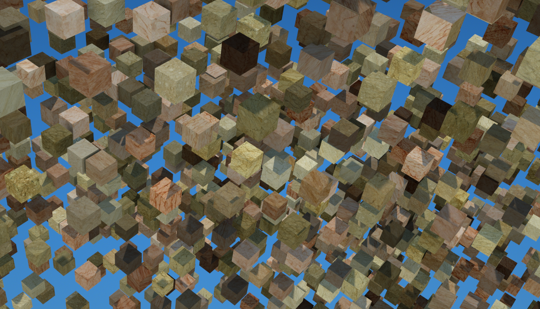

YES!!! :D :D :D :D :D :D :D :D :D :D :D :D IT WORKS. I am happy like a kid :)
At the screenshot you see one box, two textures and almost 2000 UVed instances - (almost, up to 256 variations) all look different.
So now it's time for more wishes :)
1. Could you please code extra option to select not only a folder for texture path but also a single image, or holding ctrl more images?
2. Could you please code extra option to lock U and V scaling together?
What is your opinion: is it possible to create just a node that would replace the script and it would have inputs same as inputs from the panel?

smicha wrote:YES!!! :D :D :D :D :D :D :D :D :D :D :D :D IT WORKS. I am happy like a kid :)
That's unfortunately not supported in the current Lua API. We may add this in the future, but I don't have time right now.
Have been thinking about this myself and will do that when I get to it.
We won't do that, but we are planning to implement a generic Lua node graph, where you can hook up a Lua script, that gets evaluated every time an input changes, which would allow this and many many other things. The problem is right now we don't have time to do it, but it's definitely planned.
