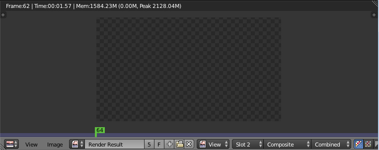

I have a simple animated camera in an architectural scene. I'm using the particle system for a gras floor (particle object is in the "scatter" mode. When I click on the animation button, the rendering starts just like it should. When the first frame is rendered (correctly) the rendering goes on but without any gemoetry. That means there are rapidly imagefiles saved per frame (each within a secound) but they have no content. The window with the render result shows this:

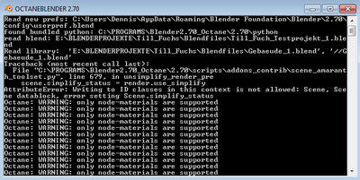

...and this is what is shown in the console:
I'm not shure if what the console shows is realy related to the problem...
To me it seems as if the OctaneServer doesn't refresh the geometry automaticly. I've the same problem after rendering a single image: When I try to start another rendering it is renderd without content. The only way to work around this is to restart blender!
