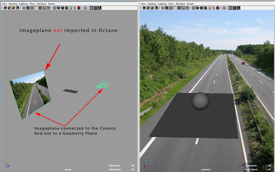

Yes i saw your Video but my main Question is When i Use a Backplate in Maya ( The Backplate in Maya is attached to the Camer and not to a Geometryplane ) with my Matched Camera would i see the Backplate also in Octane or not??
And i know i generally would compose it later in Post, but i need this to see my compleet scene for Lightning and Shading.

Hi its me again.
Yesterday i asked you is it possible to export the Imagaplane as well with the Camera in Maya to Octane, you said yes.
So i tried this and the Imageplane wich is connected to the Camera ( not a Geometry Plane ) dont export to Octane.
:cry:
Or is it not possible ??
thanks

You need to use the maya export plugin, and post a question in the maya export forum so the maya peoples (bazuka, etc...) can help you.

And i use the Maya export Plugin.
