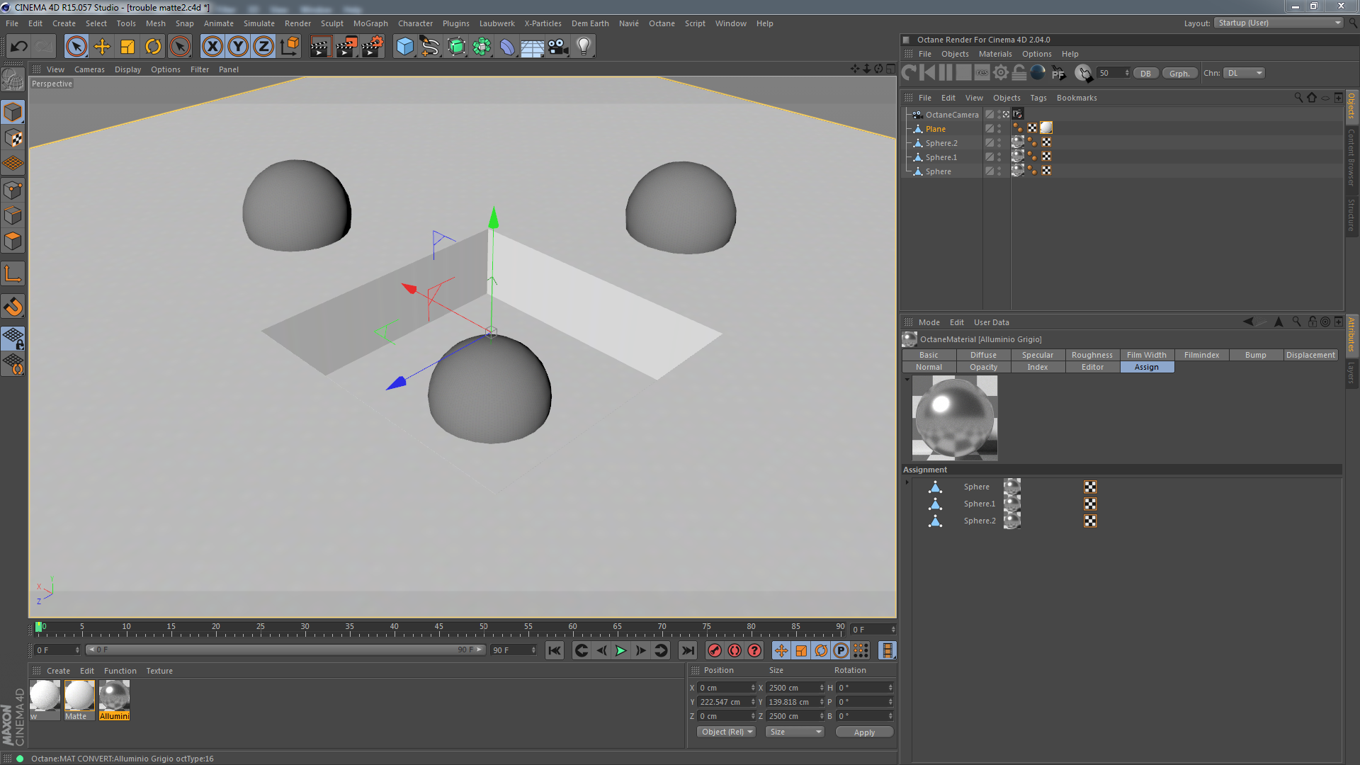

Looks like the matte object can not receive AO. Only the shadows.
Is this true, or am I doing something wrong?
Matte object is the only solution for non-functional camera mapping. (maybe than one, but the easiest)
Matte object/material

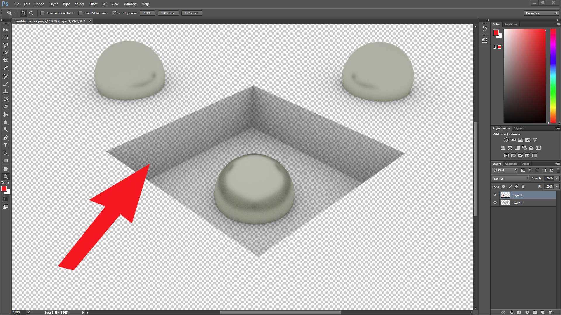

Matte function works perfectly with diffuse material on the plane objects.
Remains unanswered question - how to get rid of the shaded area in the pits or inside the objects, which is used to mask with mate-material?
How to get clean masked object with alpha? Can anybody help?

If I understand well you just need to delete poly from the side just keep the 2 horizontal
Or do two renders, one for each height.
Thanks for the response.
Meaning of the question is how to make a complicated mask with alpha channel for a complicated object using a matte material.
This example is a simplified version of the problem. Not for the fake solutions.
How to remove from the material properties of the response to self-shading and occlusion?
Anyone can help? Or maybe in next release?
