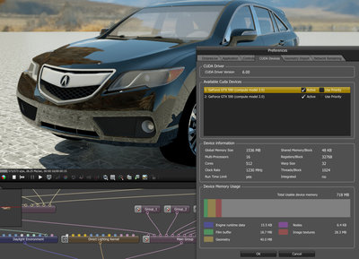

sorry, but you don't give enough info and i can't find much time to digg every install problems. What's your nvidia driver? does standalone 2.03 works well, can render some scenes?moontooth wrote:re-install
clean everything
try 2.02 2.00 2.03 version
tried lots of solution
still can not get card![]()
don't know why
Standalone 2.03 is working well and R14 tooaoktar wrote:sorry, but you don't give enough info and i can't find much time to digg every install problems. What's your nvidia driver? does standalone 2.03 works well, can render some scenes?moontooth wrote:re-install
clean everything
don't know why

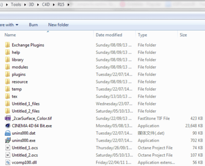

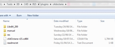

I attach my R15 folder screenshot maybe I missed something

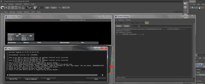

remove vcomp100.dll and try again. Send me a console window and octane log output, if it still don't works.
Still not workingaoktar wrote:remove vcomp100.dll and try again. Send me a console window and octane log output, if it still don't works.
R15
render log:
Started logging on 23.07.14 04:57:09
OctaneRender version 2.03 (2030000)
CUDA error 999 on device 4294967295: An unknown internal error occurred.
-> failed to initialise CUDA driver API
There is no CUDA device which is supported by Octane Render...
FILE PATH=F:\Download\3D\model\car\03\MDX\mdx.fbm\vpc_v1_002_tire_normal.png
Can't write bool to static pin 'power' (P_POWER, type PT_TEXTURE) of node 'RGB Image' (NT_TEX_IMAGE, 0000000045070FD0)
Could not pick, because we have no render threads.

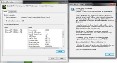

It's saying no Cuda device with some error. I'm not sure how can you render in R14 and SA. What's your nvidia driver(3rd times i'm asking)?
Also suspecting for other plugins. Someone which has cuda dll's can cause conflict
Sorry aoktar I'm misunderstandaoktar wrote:It's saying no Cuda device with some error. I'm not sure how can you render in R14 and SA. What's your nvidia driver(3rd times i'm asking)?
I was thinking you want to see CUDA version
ok i'm going to beginning. What are you seeing here?
IMPORTANT INSTALL NOTE:
This version requires Nvidia driver 335.xx or newer. Also matching version of Standalone 2.0 is highly recommended.
And remove all old plugin files before installing. Any version conflict or old drivers can cause crashes
aoktar wrote:ok i'm going to beginning. What are you seeing here?
Sorry aoktar, I missed this part. I'll update my driver now
