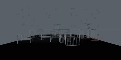

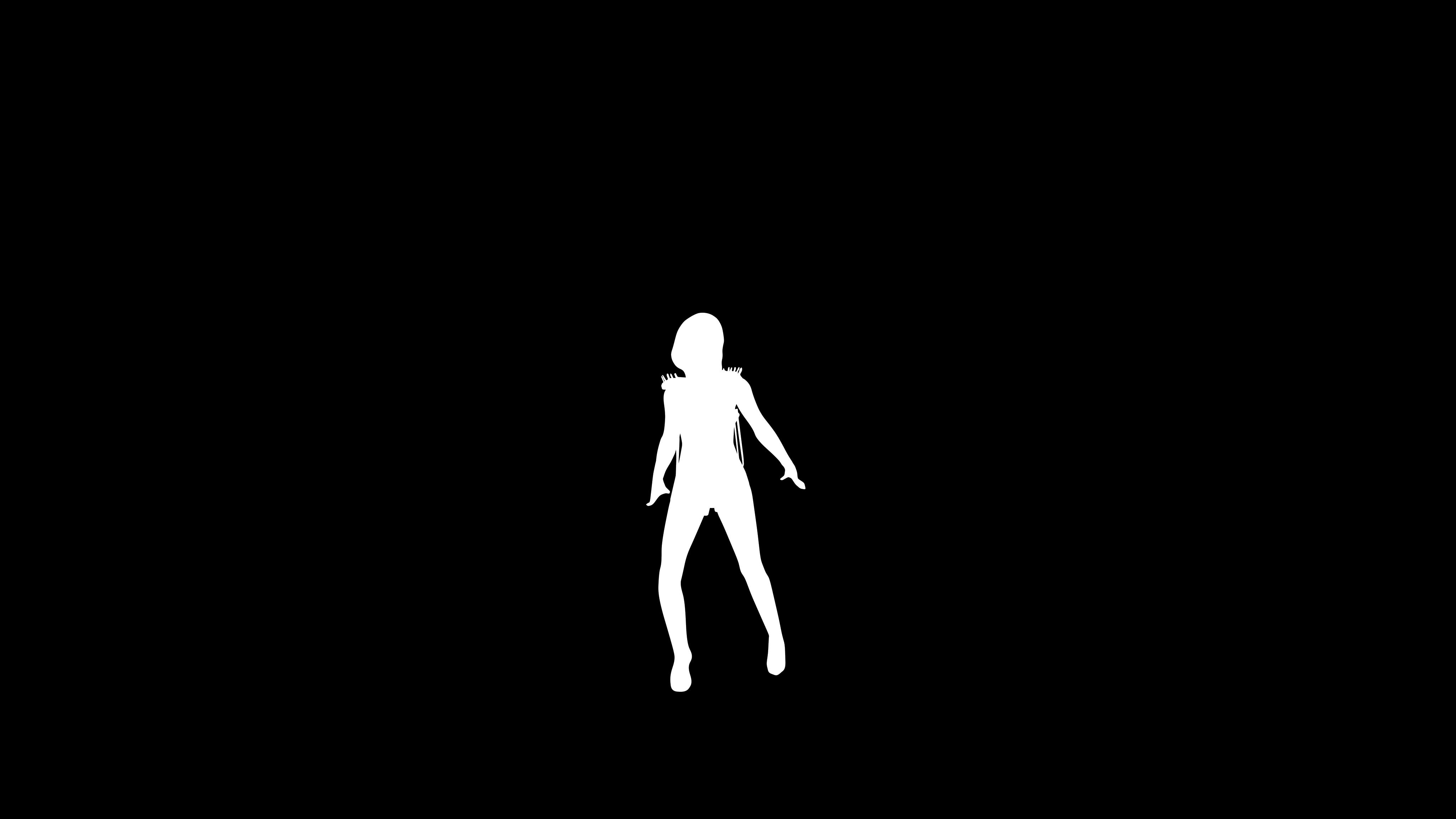

Could you give us some insights of your composeting workflow, especially the bed scene at 3:00... how did you use octane without passes and composed the CG so well together with the real footage? Was the woman rotoscoped? The beds just rendered without background and then comped in AE?
Any special tricks or problems to get solved in the workflow?
I didn`t try mixing octane with real footage yet, but maybe will have to soon.

first i tracked the scene, then i rotoscoped the women. then i animated,shaded and rendered the beds light by an HDRI with shadows cast onto a matte material plane and composed all together in aftereffects.
thats it.
