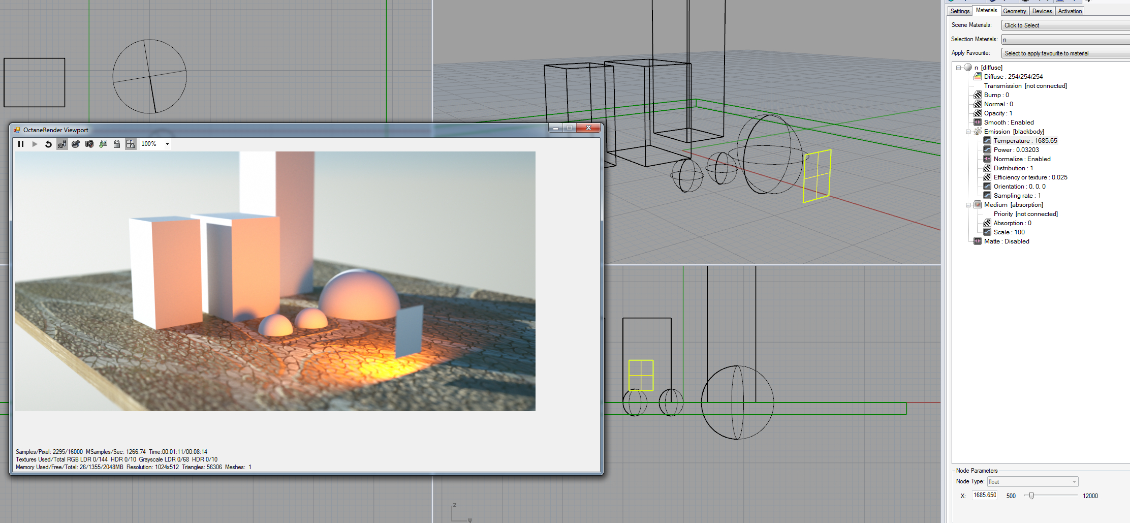

Hi All,
I can get an emmitter to glow orange and red using the temperature but how do I get a green or blue light?
Cheers

Change the emission to a texture emission (rather than blackbody) then you can specify an RGB color for the emission.
Thanks!
Chris.
voon
Posts: 527
Joined: Tue Dec 17, 2013 6:37 pm
Yes ... connect an RGB Texture node to a Texture emitter node, whiche you then connect to the shader node.
Note that depending on the power and RGB settings you still get irritating color changes :)

Thanks for those quick answers. That works a treat.
