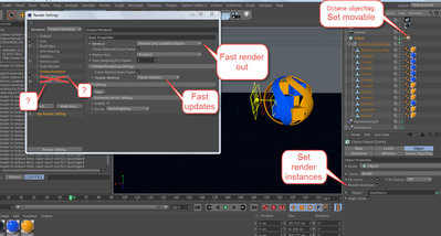

i couldn't stay away more. Sorry but how could you do so many wrong things together to make it so slow?
I have pointed wrong and correct things to make it very fast. But annoying things is small icons makes very slow rendering. If you change them with spheres, everything will be much faster.

I made a few changes and it is rendering away now very quickly :.))
You are right I could have used spheres with a texture map on them... I'm just experimenting :>((
