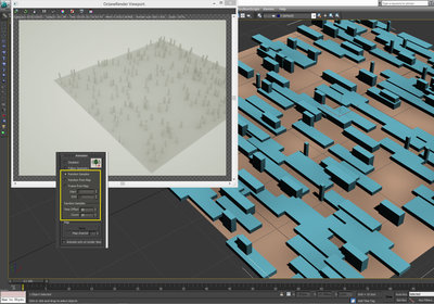

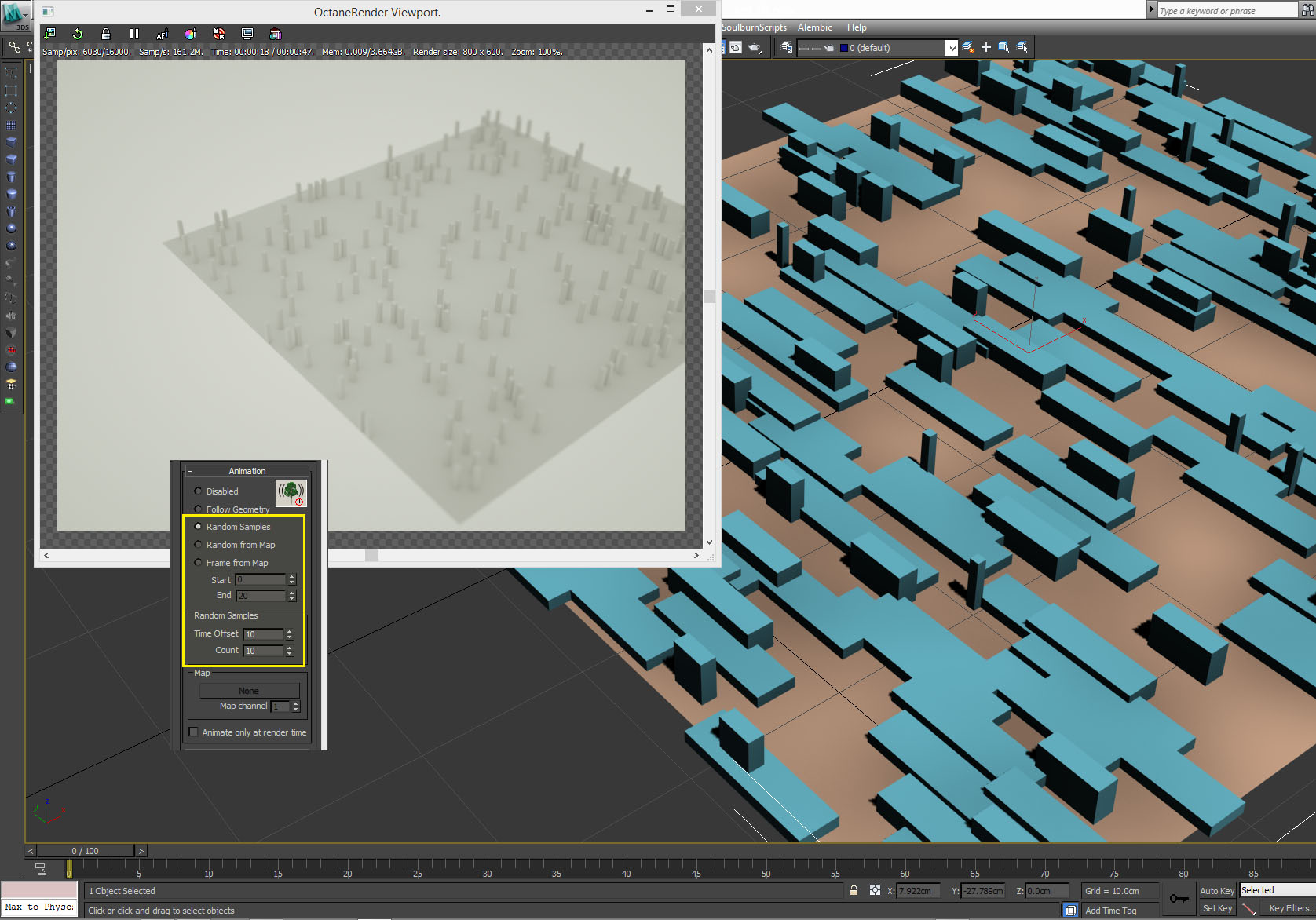

I have been testing Forestpro for animated crowd creation using the offset function. I found that it updates the offsets in the viewport but not in the Octane render. Has anyone else got this working.?

We are trying to create crowds of animated people from instanced geometry. We are trying to randomly offset animation start times, which forest can do.

hmm I thought that worked. did a project with wind animated plants with octane 1.3 if I remember correctly and I used that feature..

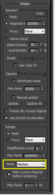

edit: i actually just got it working, not working in the viewport anymore, but in the rendered frames. strange.
forest object -> display -> render mode to "meshes"
I don't know exactly what this is doing. could be that it looses instance information.. maybe check the forest pro reference.

ok did it for you:
itoo wrote: In "Automatic" mode, the plugin uses all capabilities of the renderer to get the best results in complex scenes, creating automatically instances, meshes or proxies according to the type of objects defined in the Geometry rollout. Currently, this mode is used only in Mental Ray and VRay.
In "Meshes" mode, Forest creates a single mesh containing all trees. This mode may useful, as instance, if you want to create a Forest object that uses another Forest as tree sample (this must use "Meshes" mode to work with MR/VRay).
maybe your crowd fits in your gpu memory? if not this is of course a no-go..
