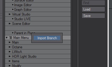

After install the plugin you need to import the menu branch as you can see in the attached image, clicking with the right button over the main menu root folder.

Thanks! That did the trick.
