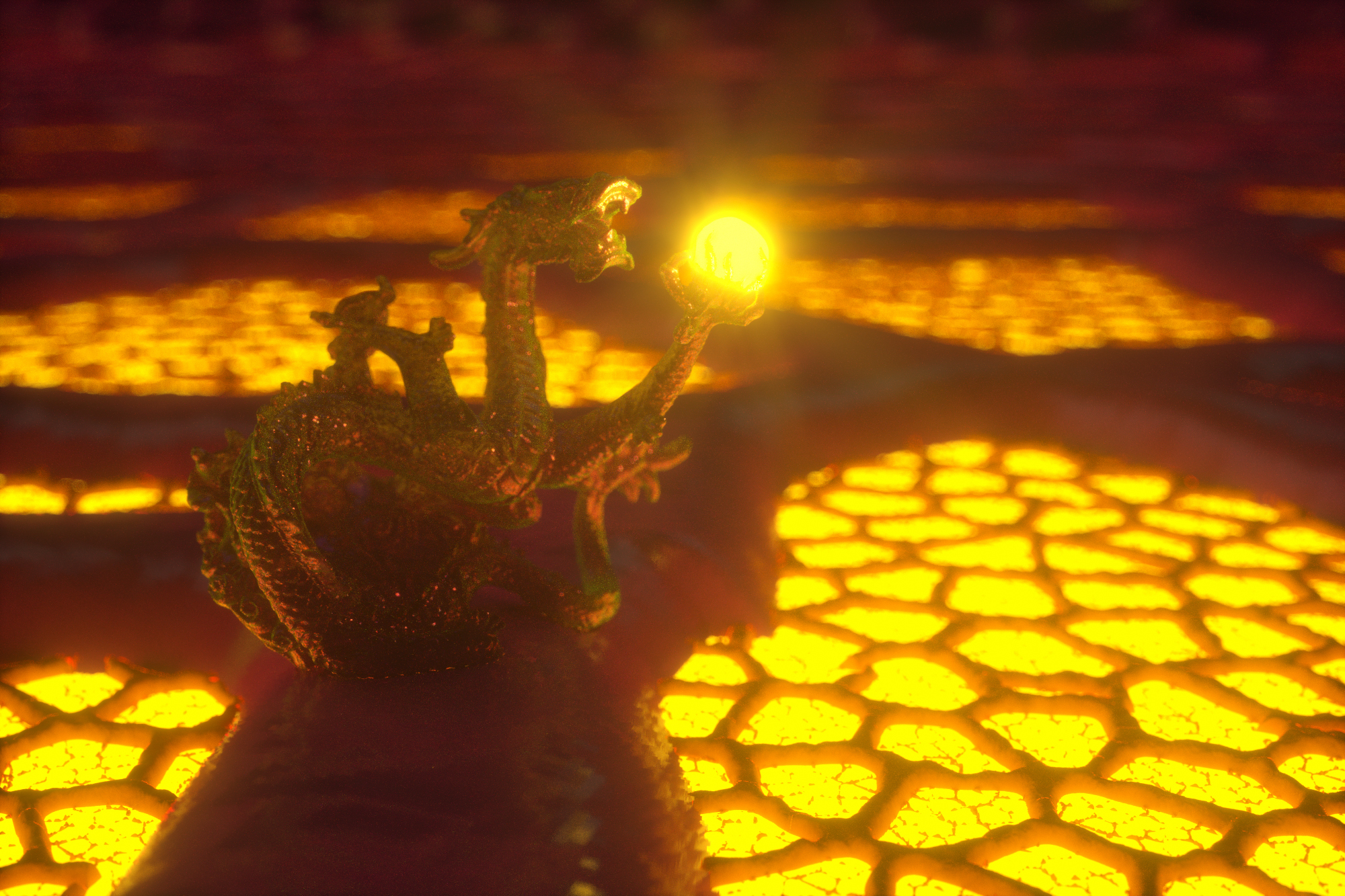

All the floor is just a simple dispalcement. Amazing... it is a simple plane. Very nice feature fellahs
Messing with some displacement

Very cool!
But I don't get how you did that with the emitter? Is that a displacement map with an emissive plane under?

yep you guessed it.
4 planes . three have displacement two or which have emissive and one plane just emissive.

yep you guessed it.

Holy crap that is just awesome.p3taoctane wrote:All the floor is just a simple dispalcement. Amazing... it is a simple plane. Very nice feature fellahs

Nice Peter
Hmmm, a dragon and a yellow ball... it's missing a red star on the ball!
