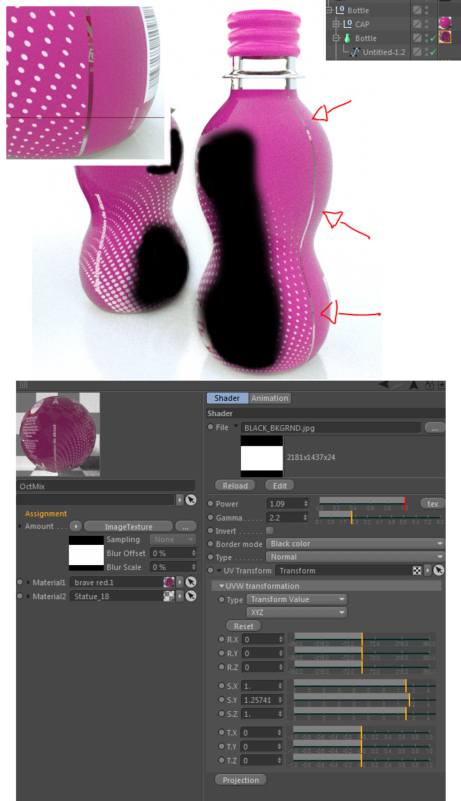

Hello, im having some problem using the MixMaterial with Galss in a Lathe Obgect in C4D, dont know if im doing something wrong, but I try everything to fix this issue, this is what is happening..

is this sample enough for you?

YES!! tks
I was not using the UVW Map
