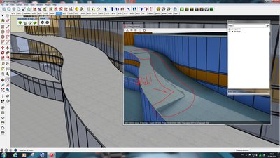

artifact with integrated plugin and not standalone
ppoublan
Posts: 56
Joined: Fri Nov 18, 2011 8:47 am
Is there a way to fix it ?
Attached in zip is the skp file.

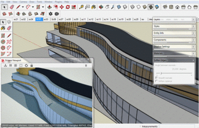

Hello mate, you just need to go to SU "Soften Edges" and reduce the angle of that group/component.
Then all is good.
cheers

I tried to change "soften edges" within SU, checking and unchecking soften coplanar face, but got no change in Octane result.
The artifact appears on a plane surface within SU.
I suspect this to be linked to the way Octane triangulate surfaces...

hello mate, you probably missing a step.
If you remove de angle of any group/component in SU you need to refresh Octane Viewport, because new geometry settings are saved. Another thing, groups inside groups can have different soften value, so we need to select that part(group) and correct the soften value.
I don't soften geometry in SU, i use the smooth option in Octane.
Check here how i did it.
cheers
