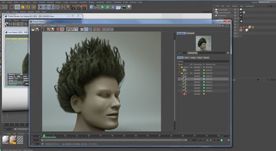

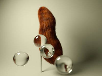

Demo for 2.0 is nearly ready. Some documentation is missing. I'll publish it today or next. Yes, 2.0 has hair support. Integration is little tricky and not %100 compatible with hair material, but mostly works with hair effects.

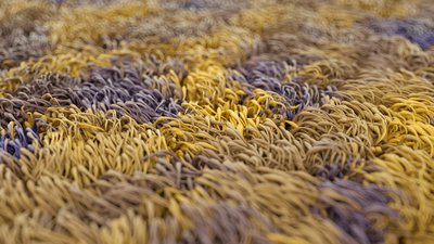

[vimeo]http://www.vimeo.com/93379557[/vimeo]
[vimeo]http://www.vimeo.com/96093057[/vimeo]

these are exposed in forum in development period, but it's not visible to public.
This is another complex test with a preset scene of R15.
