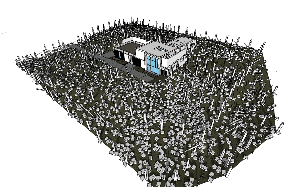

well here is a scatter/proxy test :twisted:
I'm in love :shock:
Its just amazing....I cant even imagine when we nail down all the little bugs.
You rock Fuzzy. 8-)
