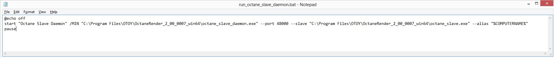

If not please try this
1) Right click on run_octane_slave_daemon.bat in the startup folder and click edit
(It should come up in notepad or some other text editor)
2) put "pause" at the bottom and click save, it should now look something like this:
Now close notepad and double click run_octane_slave_daemon.bat. Does anything come up now? If so please post a screenshot.
Chris.

thankyou for your help. I edited the .bat file and i then get a cmd.exe window which says "press any key to continue". then it just goes away and nothing else happens. This is my bat file content
@echo off
start "Octane Slave Daemon" /MIN "C:\Program Files\OTOY\OctaneRender 2.00\octane_slave_daemon.exe" --port 48000 --slave "C:\Program Files\OTOY\OctaneRender 2.00\octane_slave.exe" --alias "%COMPUTERNAME%" --gpus "default: all"
pause

ltchest wrote:thankyou for your help. I edited the .bat file and i then get a cmd.exe window which says "press any key to continue". then it just goes away and nothing else happens. This is my bat file content
@echo off
pause
Can you please remove the pause again and change the 2nd line to:
ie: remove the text "--gpus "default: all"
So the file should read:
@echo off
Chris.

Thats it - thats really nice ! thanks. So was that my incorrect syntax regarding the GPU count ?
