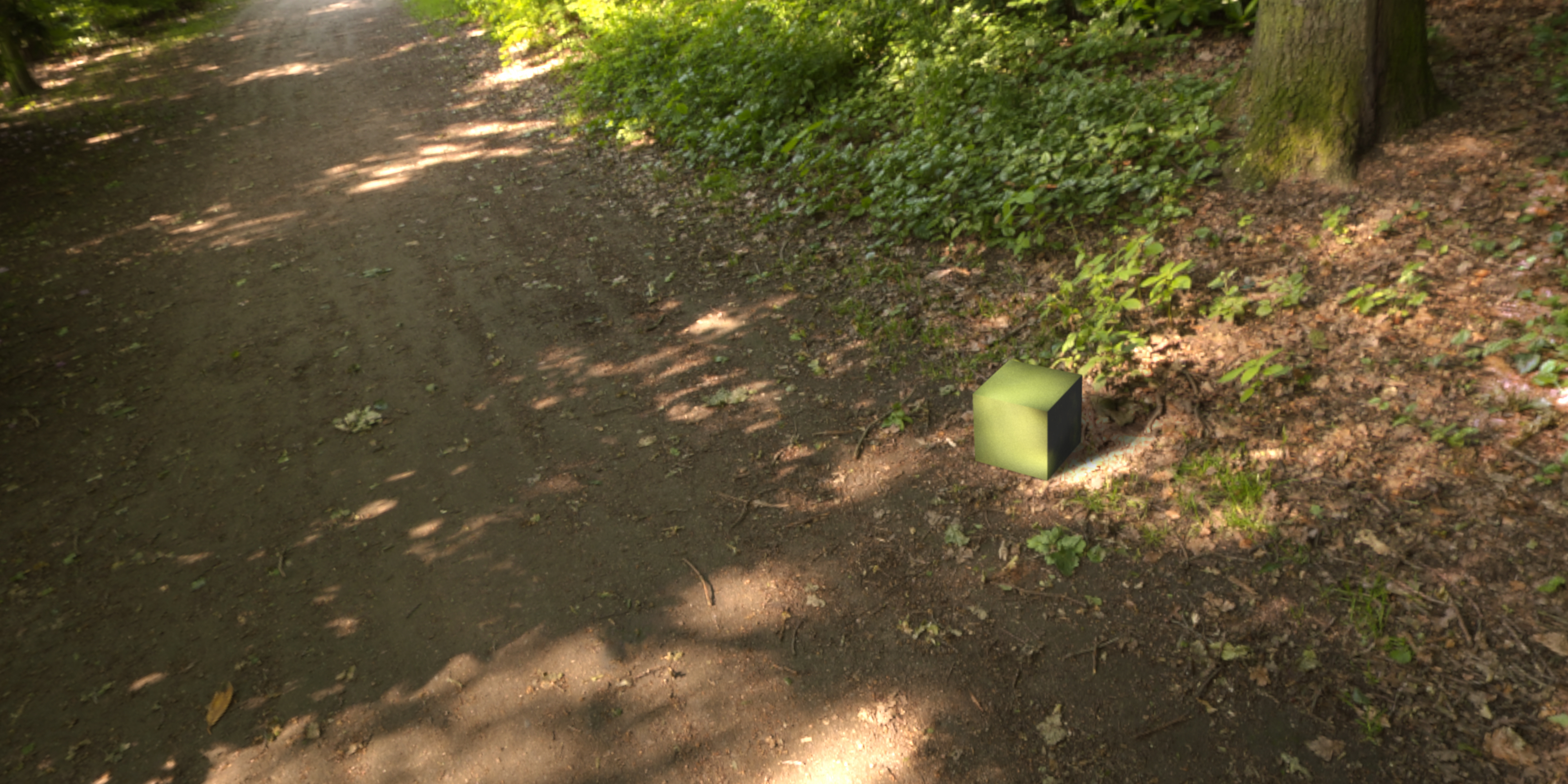

I did not know about the Object Layer Node. That is so cool. Thank you for the info!!! :)

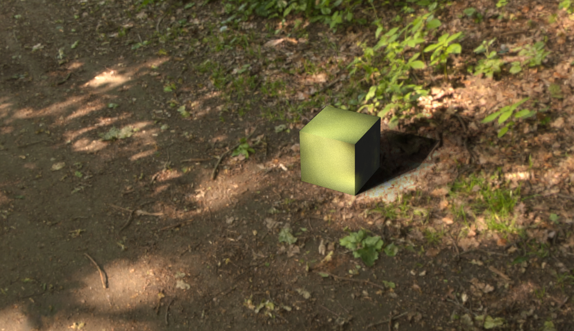

This is WAY cool. Here is my first shadow test:
This kind of thing may take a while to dial in, but it looks promising.
The only problem as you say, is that the Object Layer Node does not prevent the reflections of the object from appearing. Big bummer. So until and if that changes, this technique requires doing a separate render where the affected objects that have glossy or specular materials are replaced by diffuse only, so the shadows and light leaks can be captured. Then it would have to be composited in Photoshop over the original render to provide an exposure-like adjustment for the areas receiving direct light.
'm not convinced your idea is very workable but I love being proved wrong by interesting ideas so I'd love to see some results if we ever get that control in Octane.
This seems workable. For the reflections issue, the only solution for now is compositing multiple passes in PShop. Actually, this test involved a shadow catcher pass, my light & shade pass, and a lone HDRI background pass. I tried to combine the shadow catcher pass and the light & shade pass in one single pass, but if the shadow catcher plane intersects the invisible sphere, that intersection shows up as a rendered circle. So it's not so invisible anymore. :(

A slightly touched up version to match the blur of the box to the HDRI, make the cast shadow less contrasty and get some bumpy shadow at the very bottom:
I also think that because this is a very simple box, with no rounded edges or textures, that if it seems to work with that, then I think the effect will be even better with a really complicated, more realistic mesh, since the basic realism of the mesh will be so much better.
I think I might try this with my car mesh. I'll just put the ball around it and see what happens.
