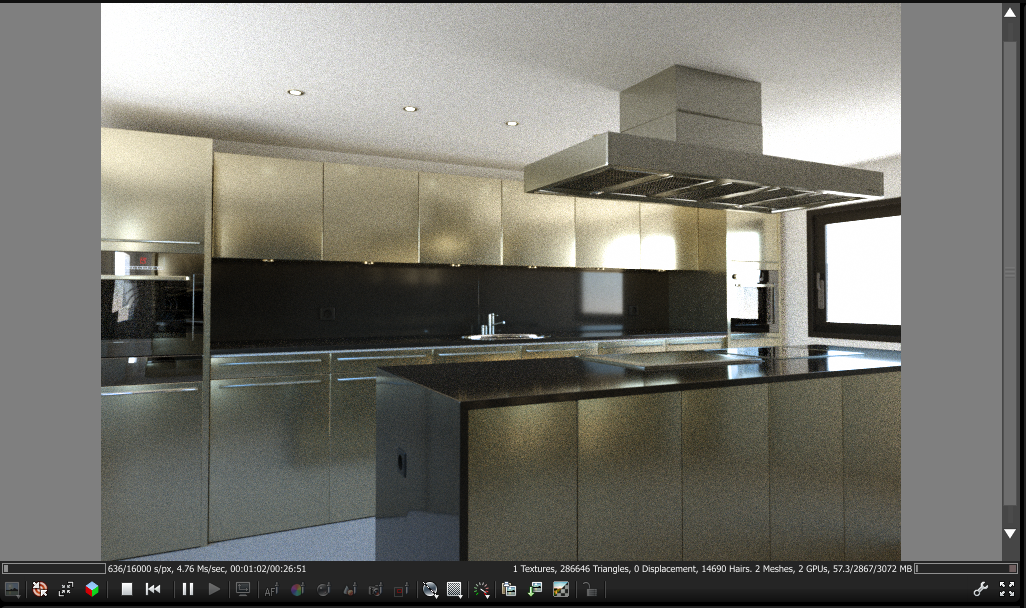

Octane 2.00 (export 3dsmax with 2.0 plugin)
636/16000 s/px
4.76 Ms/sec

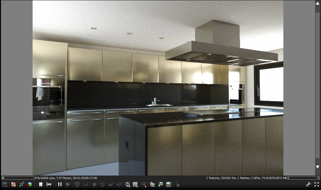

Octane 1.53 (export 3dsmax with 1.53 plugin)
976/16000 s/px
7.47 Ms/sec

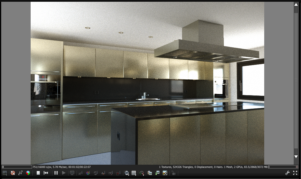

Octane 2.00 (export 3dsmax with 1.53 plugin)
751/16000 s/px
5.78 Ms/sec

With rounded edges:
636/16000 s/px
4.76 Ms/sec
No new features:
976/16000 s/px
7.47 Ms/sec
The strange part comes when i use Octane 2.0 but the export had been done with 1.53 plugin (no new features).
751/16000 s/px
5.78 Ms/sec
