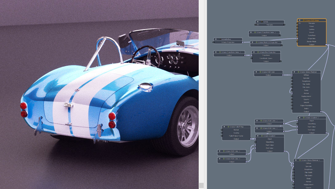

Hi, i dont know if im doing something wrong, but there is a problem in use of the normal maps in box projection... it using the uv to shading!? well... a example here:
Look at the back
Here is the UV..
And the material:
Did i something wrong?

I'm not sure I can see how you would use a box projection on that car. That would apply the normal map to each of the 6 sides of the car, and give the effect you are seeing in the render.

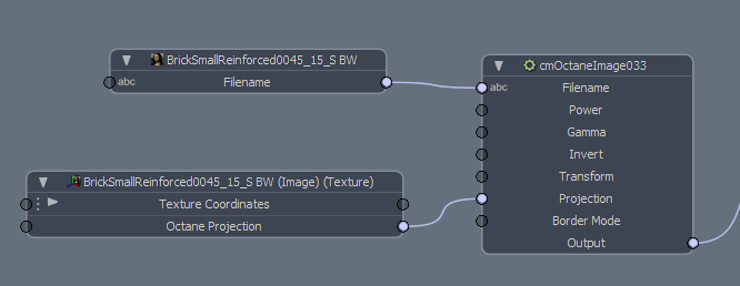

Regardless, IMO you are better off using the Texture Locator in the Shader Tree to feed the projection pin of the "Octane RGB Image" you are using for the normal map. If you do this, the plugin will do all the work for you, and you can simply move the texture locator, and the transform will be set automatically. You can set "Box" in the Projection Type of the texture locator. This is covered in the manual at http://render.otoy.com/manuals/Modo/?page_id=169.

Paul, i had tryed all projection types, and all of them is giving me the same shading error... even the uv projection... see:
Hi Marcus. I'm having trouble seeing what it /should/ look like if working correctly. Is the normal map for the water drops? If so, it looks like it rendering correctly in the image you posted.

I think this will make more sense... when i disconnect the image node from the rgbimage note, the error still there and be more visible...

AW.. solved it.. i just removed the normalmap output from the base rough paint... just let it on the gloss overlay... i think the mix material do some crazy thing about 2 same normal maps... well.. here it is...
Ah OK - you might be right - having 2 normal maps might be confusing something. Happy to investigate further if you send me a test scene (could be a sphere with the material you posted).

Thanks for posting that scene. If you plug that normal map into a diffuse material and apply to the bodywork, the crease is obvious. I have escalated this to Otoy to determine the problem.

Marcus - Otoy have looked at this and identified it's an issue with the normal map.
The colours in the normal map are a bit off. A value of (127 127 255) in the image corresponds to no distortion. The normal map here has (165 165 255) as background colour which corresponds to a constant distortion in some direction, so you will see the seams where the UV mapping changes orientation.
