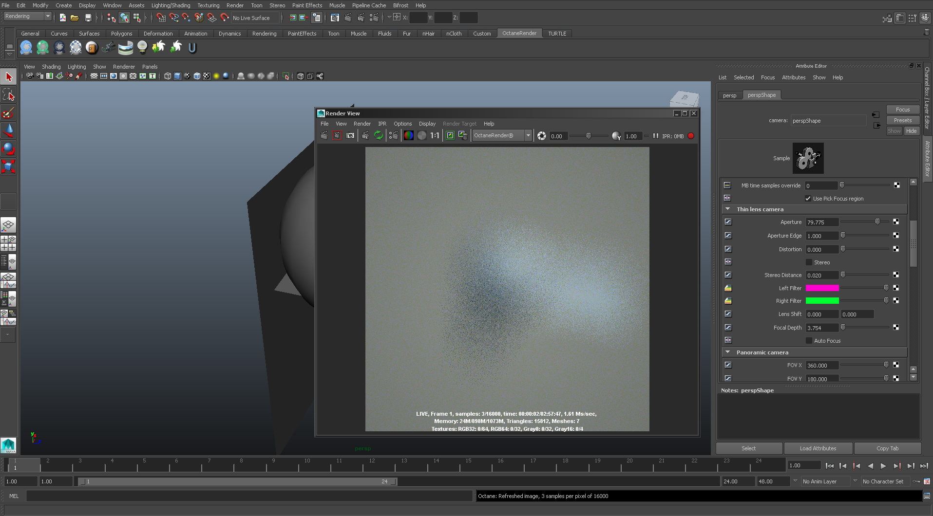

camera focus is not working ~ even with a high aperture

also when you create a new camera, the IPR does not update to reflect the resolution gate of that camera ~ I created a new camera with an aim, but when I crank up the aperture, the background stays in focus even when I turn off Auto Focus ~ so autofocus is buggy in this build

solomon wrote:camera focus is not working ~ even with a high aperture
Can't reproduce...
Can't reproduce...
hi JimStar, trying creating a New camera, and use that for IPR

solomon wrote:hi JimStar, trying creating a New camera, and use that for IPR
It seems you just start the IPR session with default perspective camera instead of with just created camera... As all is still OK on my side, even with just created new camera...
is auto focus working on your end even with a new camera created?
