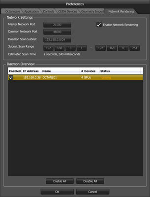

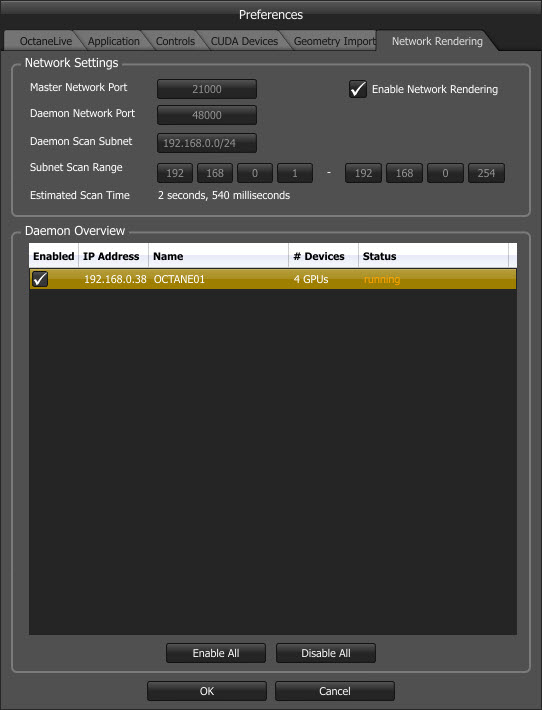

I figured out the problem. You have to make sure standalone does not have a scene loaded in it. the update is really quick between checking the slaves and the plugin adding them. It would be really nice to not have to open standalone to do this.
I still run into a few problems with connecting to slaves, some computers will see them while others wont.
Another issue I ran into is that the limit seams to be 11 cards? and sometimes even though the slave is connected it wont be used. I think this is a standalone problem.

Thanks... All Feature Lightning Speed
Displacement Need Edge Continuity. But Ok.
NetworkRender (GPU DR) Not Friendly.
Want Standalone Network Render Setting Page into C4DOctane Setting
Need More Control Page.

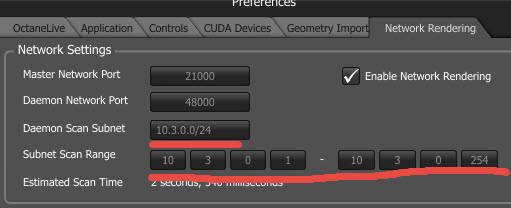

Most Office Have Internet Connection. Using Router.
Maybe Router Problem. My guess
First Running Octane Standalone.See below
Daemon Scan Subnet is Router Range. Not Local Net Range
If Using Router... C4DOctane Scanning Subnet Only Router Range. (My guess)
You can change Scan Subnet in Standalone.
But C4Doctane Have No Control Page.
We need control Page C4DOctane.

I have been giving this a go myself.shawnfrueh wrote:I figured out the problem. You have to make sure standalone does not have a scene loaded in it. the update is really quick between checking the slaves and the plugin adding them. It would be really nice to not have to open standalone to do this.
I think because the plugin does not have the network rendering interface (that i could find!), using the daemon on the slaves is hit and miss (you are probably just effectively using the standalone to get the daemon on the remote machine to start a slave, which by chance is connecting to C4D rather than the standalone because it was the first thing to start listening on port 21000).
I found the only way I could get the slave GPU's working in C4D was to run the slave explicitly pointing it to the master machine.
When you run the plugin with networking enabled, it will most likely use the default port of 21000 to listen on.
Then run the slave on the remote machine like this: octane_slave.exe --net-master-port 21000 --net-master-address MASTER_IP_ADDRESS_GOES_HERE
eg:
c:\program files\OTOY\OctaneRender 2.00\octane_slave --net-master-port 21000 --net-master-address 192.168.1.20
thanks
chris.

FooZe wrote:I have been giving this a go myself.shawnfrueh wrote:I figured out the problem. You have to make sure standalone does not have a scene loaded in it. the update is really quick between checking the slaves and the plugin adding them. It would be really nice to not have to open standalone to do this.
eg:
thanks
chris.
You Are Genius...... It's Working
Thanks....
