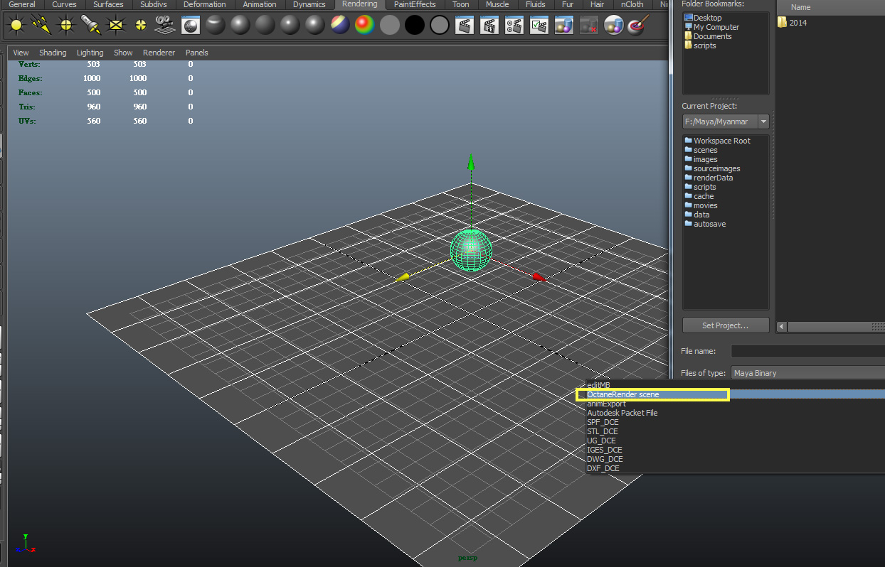

hyubrad
Posts: 50
Joined: Thu Aug 26, 2010 1:52 am
JimStar wrote:Use standard Maya's "File/Export All" menu. And choose Octane alembic export type.
HI. JimStar
I only see the octane scene in Export menu .
Win 7 x64 | MAYA 2016 | OctaneRender 2.3 | GTX 980TI * 3 | CORE I5 2500 | 16 GB RAM .
