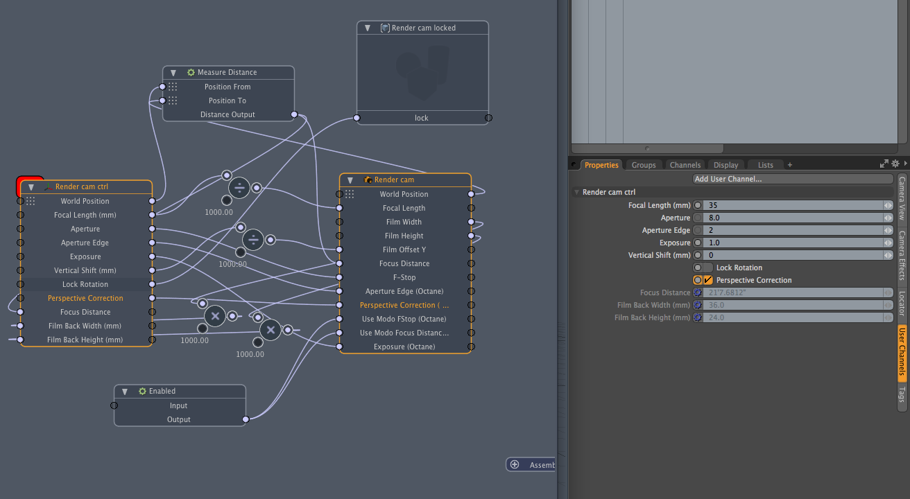

I'm creating a camera rig assembly that pulls together some MODO and Octane settings that I want to access to, as well as some other functions. However, when driving the render camera from a user channel, the Octane preview doesn't update unless I manually refresh. For example, if I change the focal length from my user channel, the MODO camera updates in the app viewport, but not in the Octane render. Same thing with a simple on/off boolean for turning on perspective correction. I have to refresh the scene. Do you know what's causing this?

Hi John - the Octane camera updates when the plugin receives a channel change event for the render camera. If you are driving it from nodes, the node value is changed, but the plugin does not receive a camera change event - so it doesn't update. Rendering an animation should still work correctly - and when you do a scene refresh, you might still be able to move the Modo timeline to see the camera movement if you have "Load All Frames Into Octane" ticked (although I haven't tried this).

Ah ok, thank you. Obviously there's something else going on from MODO's end which enables it to recognize updates to driven channels and update its own viewport automatically, but I'm guessing that functionality isn't available to the API.
It is available to the API - but the plugin would need to iterate through all child-parent relationships of every item which is changed to see if the end parent item is the rendering camera. Whilst this can be done - it adds a little more lag every time you update any channel on any channel modifer - and I don't think people want this. But if the need is great enough, it can be done. But I would have thought the important thing is that rendering animation works correctly - which is should do for your rig.
