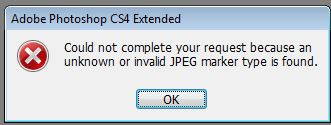

One (small?) issue has shown though. When I export the render as JPG, I can't open the file in Photoshop. My imageviewer can show the file just fine, but not photoshop :-/
I'l try to find a solution so I can play with this wonderfull new toy :-)

Hi Jorgensen,
Be default OctaneRender saves all images as png files with alpha channel.
Renaming file to JPG will write an image as a PNG file.
I'll consider this issue in the next release.
But for now just rename the file to PNG.

Ah ok. No problem then - thanks :-)
