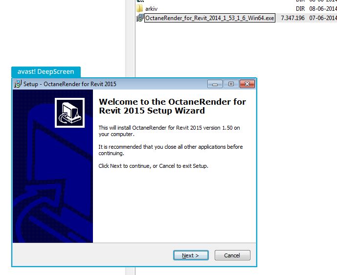

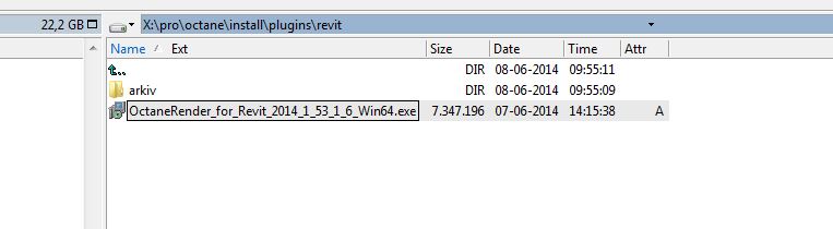

When I start the installer it say's for Revit 2015. But it installs fine.
But when I restart Revit I get an error and have to reinstall the plugin.
This morning Revit came with an error "faild to open document" I have never had this error before. Can it have something to do with the plugin?
I have added some screens.

What version of Revit are you running pls?
Jorgensen
Posts: 872
Joined: Sun Jun 30, 2013 10:53 am
I'm using 2014, and downloaded the plugin for the 2014 version.
HOME octane standalone v3.07 | octane plugin for sketchup 3.07.0.14 | sketchup pro 2017 17.2.2555 64 bit | windows 10 pro 10.015063 build 15063 | i7-6700k @4.0 GHz | 32gb ram | 2x gtx 1070 | nvidia driver 382.33
face_off
Posts: 15830
Location: Adelaide, Australia
I just checked the 2014 installer - and as you say, it is displaying the wrong Revit version - but all the files are indeed for 2014 and should work OK. I will fix this in the next release.
Are the files OctaneRender_for_Revit.dll, octane.dat, octane.dll and vcomp100.dll present in c:\Program Files\Autodesk\[your revit version]\?
