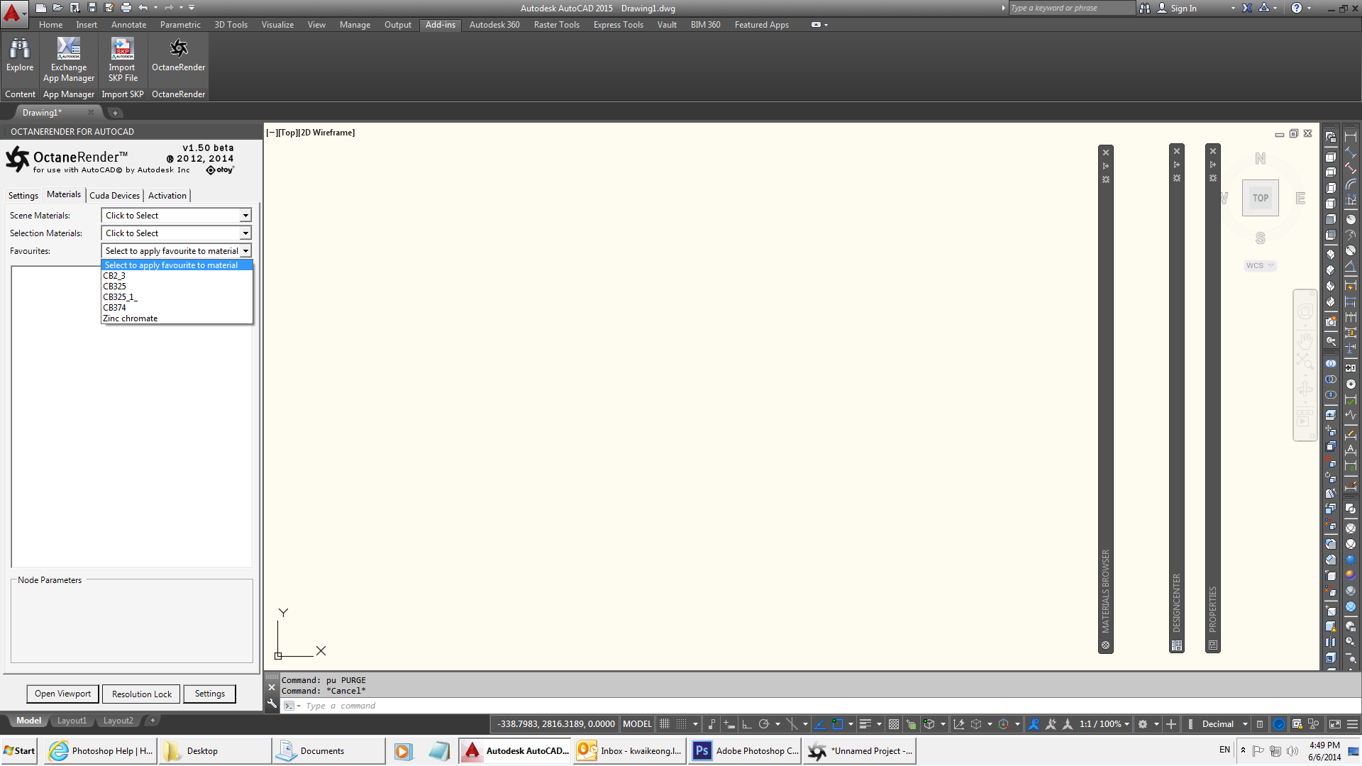

Favorites are stored in the C:\Users\[username]\AppData\Local\OctaneRender for AutoCAD\Favourites folder, so you can back them up or delete them there. See http://render.otoy.com/manuals/AutoCAD/?page_id=501 for details.1)May I know how to find out the favourites after I saved it? I can't do the backup.How to delete the unwanted favourites?
